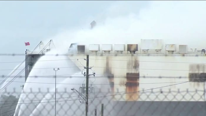

At a press conference Friday, USCG Sector Jacksonville commander Capt. Mark Vlaun said that the fire is contained to deck levels six and above. Temperatures at lower deck levels remain in the range of 90-100 degrees Fahrenheit, and the response team hopes to contain the “complex” fire above deck six - away from machinery spaces and bunker tanks. The vessel remains on an even keel, with half a degree of list and no change in draft - a sign that the hull cooling effort is not introducing water into the interior. “This is about as much success as you could hope for in this scenario,” said Capt. Vlaun
The salvage team suspects that the explosion resulted from a release of the gases that built up within the interior after the vessel’s fire dampers were closed, Capt. Vlaun said.
Mixed tactics, fire teams using a direct attack with the vents closed for an indirect attack by CO2 but with the ramp still opened.

New Video Shows Massive Explosion Aboard Hoegh Xiamen That Injured 9 Firefighters
Doesn’t anyone think that looks like steam more than combustion?? It looks like a pressure system relieving and smoke is white with a tinge of orange vice fossil fuel combustion/detonation and black smoke in the cloud which (the video quality is not awesome) seems to be dissipating the way moisture would? Sure the waste heat system wouldn’t be at normal condition at the dock with ME not running but… if the waste heat was tied to aux and aux had a problem and/or the waste heat reacted to fire fighting efforts…
