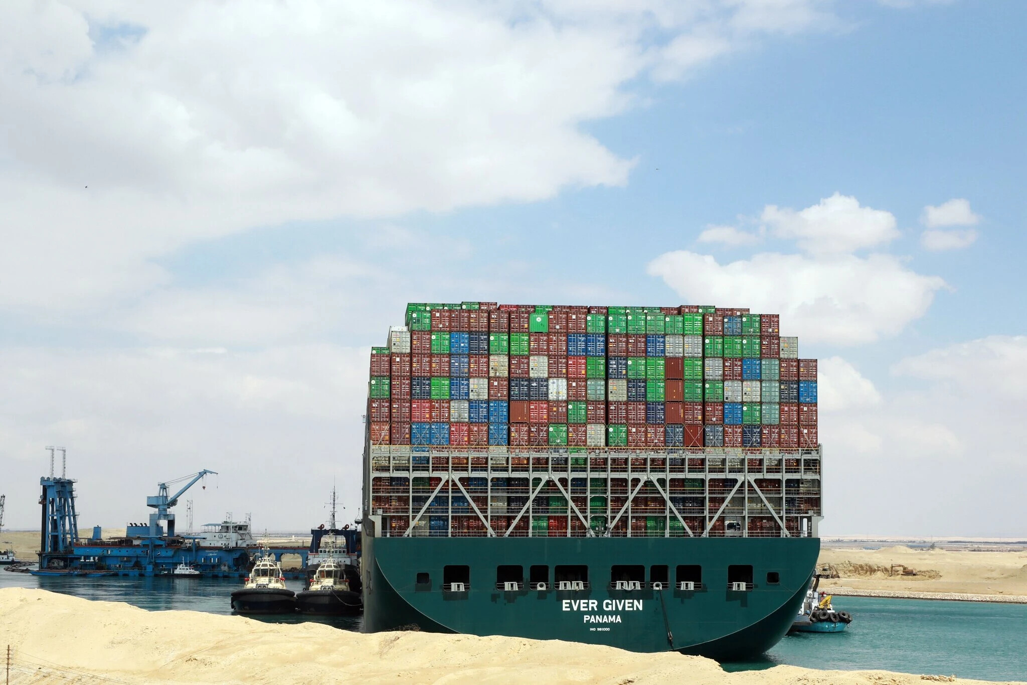

Boskalis CEO: “If all goes well, the Suez Canal ship will be open after the weekend”
If all goes well, the large container ship Ever Given stuck in the Suez Canal could be under way again after the weekend. This is what Peter Berdowski of dredging company and maritime services provider Boskalis said on television program Nieuwsuur. Boskalis is on site with its subsidiary Smit Salvage to assist with the salvage of the 400-meter-long vessel. According to the Taiwanese container shipping company Evergreen that operates the cargo ship, the colossus went off course due to a power outage and / or poor visibility as a result of a dust storm with gusts of wind at a speed of about 40 knots. That equates to wind force 9.
Berdowski hopes the plan will work, but otherwise there is also an alternative that is also being worked on. A crane is set up on land that can retrieve containers from the front of the ship. Then that part of the ship would lighten and lift a little more, making it easier to get it free. If necessary, up to six hundred containers could be removed.
The Ever Given ran aground on Tuesday morning in the southern part of the Suez Canal. Since then it has been so transverse to the navigation channel that the channel in Egypt is blocked for other ships. This affects global transport flows. The Canal accounts for about 12 percent of world trade. Nearly $ 10 billion worth of goods are transported through the canal every day.
An attempt to refloat the ship failed on Friday. A new attempt will be made this weekend. Two additional tugs are expected at Ever Given on March 28, according to a report on the website of the maritime service provider from Hamburg. "A specialized sand dredger, capable of moving 2000 cubic meters of material per hour, has been on site since Thursday to support the ongoing dredging work. Agreements are also being made on the use of high-capacity pumps to extract water from the forward ballast tanks and the bow thruster compartment ".
