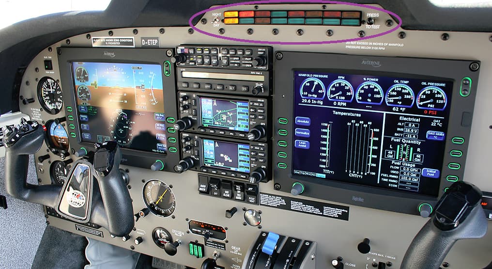

The lights that go with them should be different colours to suit the severity
Like this?
I just delivered one of these and the warning lights were nice, all in one place and color coded.
Yep got a panel just like that one.
Plus all the rest.
Anything with a screen, has some kind of alarm.
He who pays the piper calls the tune.:thinking:
Aviation is not far off: A master caution light, then a screen that shows what is in alarm state.
