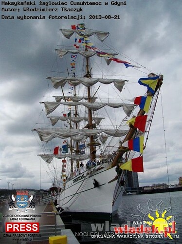

I’ve seen this same ship getting docked by a pair of truckable pusher tugs before.
CUA in Gdynia PL .
Several pcs below:
SOURCE: Meksykański żaglowiec Cuauhtemoc w Gdyni - Fotorelacje Gdynia - wladek.pl
