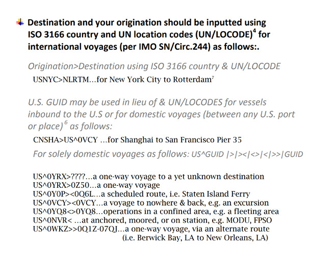

This is from the USCG encoding guide dated 05-01-2012. (It might have begun before that but this is the earliest version I can find.)
This appears to be the most current version:
AISGuide.pdf (248.3 KB)
Here’s the applicable section:
