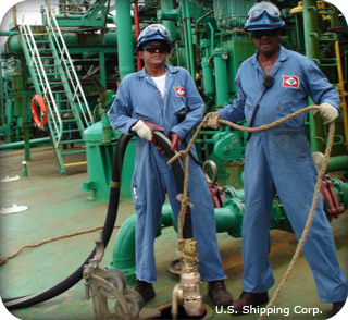

In the early days the portable Butterworth tank cleaning system was quite an improvement. It still was a dirty job to position the nozzle head at different locations in a tank, quite laborsome and dangerous too. We used caustic soda and later happily pumped it over the side in those days.
IMG_3075
Butterworth nozzle head.
