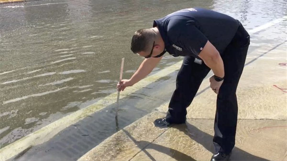

For years King Tides have been known in S. Florida, especially the paved over parts. Now with the increasing sea level it makes the news. Though this is dated one gets the idea that soon that part of the world will be uninhabitable. The water comes up thru the dead coral that Miami is built on. No dike will ever stop it.
