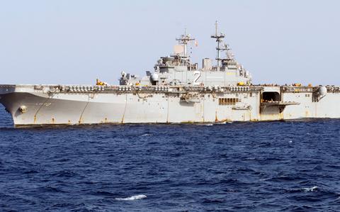

Or the Essex, when she hit the oiler she was taking on fuel from.
Apparently the XO was shouting to “watch the stern!” in from the bridge wing at the OOD, but gave no actual rudder commands or guidance. Then of course they swung their stern straight into the oiler.
Then of course there is the issue of having career aviators skipper our largest naval ships.
