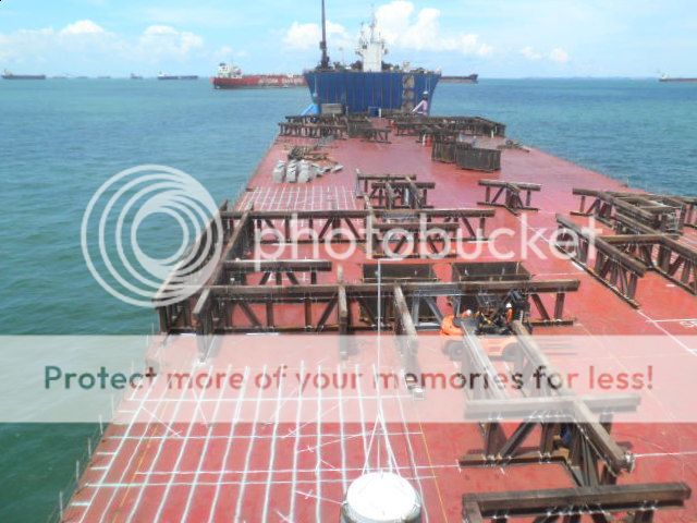

The Fitz is a relatively light load. Even high cribbing is not a problem for the larger HLVs.
Here is high cribbing for two jackups to be loaded on a HLV:
How it looks after deck dry:
Admittedly, it took some trim and list to bring this load out of the water. The Fitz would be much easier.
