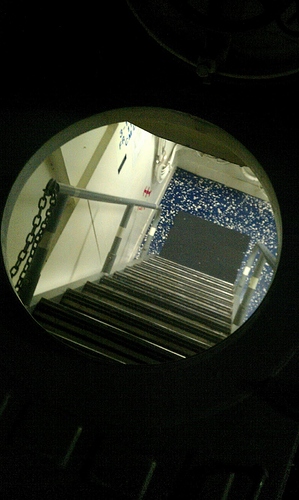

More than likely, not. We drilled constantly, at the sound of a general, chemical or collision alarm we would have been awake, dressed out and at our battle stations or damage control stations in a matter of a few minutes, all watertight doors, hatches, and scuttles would have been secured, all ventilation and vents would have also been secured. The ship would be watertight.
This blog has the pictures of both types of hatches (link) for DDG 103
EDIT: Subject matter berthing compartments would have two of these hatches (port & starboard) and each would have a scuttle in the center to get out of the space with.
Nice set of pictures from a tour of USS Barry (DDG-52) – (link)
