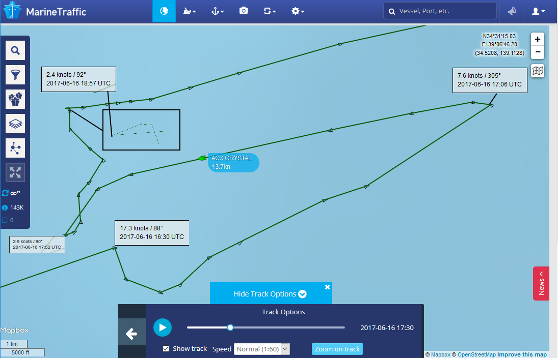

I think you are looking at the track AFTER the collision had occurred. It appears that the container vessel made an abrupt turn to Stbd. (maybe partly as a consequence of the impact) then sailed away, but made a 180 degr. turn and returned to the scene of the collision, (where the USS Fitzgerald was presumable still drifting) probably to see if any assistance was required.
She eventually proceeded towards her destination some substantial time later.
I think there are some confused journalists out there. Some are almost implying that the Crystal was maneuvering erratically before the collision, which doesn’t make sense to me. I’ve been assuming that the collision occurred at the first abrupt turn on the ship’s track, and the subsequent 180 turn and return to near the assumed initial impact was the Crystal, probably wanting to render aid if needed. I could be mistaken though. I’ve marked the following image to show where I think the collision occurred: image

I would find strange in this case (collision around16:30 UTC) they would increase speed and decide to turn back only 36 minutes later. Medias are saying 2:30 Local so it is -9h UTC witch is 17:30 the day before. So on my pic, the ship is at 17:30 UTC. I would find more logical Crystal hit around this time, slowed down, made a 180 and stick around for assistance for about 1 hour before proceeding to port. That would imply Crystal did an sharp almost180 just before and may be could see he was overtaking the Fitzgerald after this turn. More info needed…
The BBC is now also reporting that the Crystal turned ~180 degrees before hitting the Fitzgerald. I still think they’re confused. @ombugge 's hypothesis sounds more plausible to me.
Marine traffic records suggest the ACX Crystal made a sudden U-turn roughly 25 minutes before the collision with the USS Fitzgerald. It is not clear why it changed course.

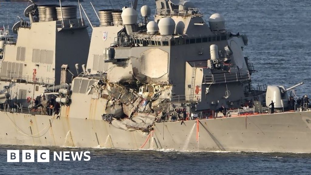

Different scenarios from the onset could have caused the visual damage in the pictures of each vessel.
The hard turn to starboard by the container vessel could also be from different scenarios.

I think you misunderstood part of my initial post.
I was bringing up two completely different scenarios that could both cause similar visual damage as seen in the initial images of each vessel.
Not an overtaking situation that an officer on watch then tries to turn around in his or her mind in to a crossing situation before safely clear of the overtaking vessel.
But two different scenarios that could have caused the damage. And I’m sure that there are other potential scenarios that could have caused it as well.
It looks like all of the news agencies are going with the Crazy Ivan hypothesis. I guess I’ll have a crack at it for fun.
  1. 16:30 UTC, ACX Crystal turns to starboard after noticing that they’re on a course to collide with a radar contact.
  2. Six minutes later they turn to port after clearing the contact.
  3. My guess on the direction of travel of the Fitzgerald at this time is ~300-350 deg.
  4. Crystal steams ahead for twenty minutes or so until ~17:00 UTC Heading ~60
  5. Crystal thinks again, maybe they don’t want to Costa Concordia their containers onto one of the little island/mountains in the area? They turn ~180 degrees
  6. The Crystal steams ahead with a heading of ~260 wanting to intercept their original course.
  7. Some time around 17:30-ish UTC the Crystal again encounters the Fitzgerald, it’s super effective.
  8. Crystal loiters for a bit to provide assistance, and check their own ship for damage, then picks up their original course and leaves the area.
  9. 22:00 UTC - SEA QUEST SHIP MGMT INC. attorneys call the ACX Crystal.
  10. 2:45 UTC - Contraband, errant documents thrown overboard, Crystal heads into port.
Ho sry then. I agree, we are doing our best guess with the little amount of info we have. Still a good exercise :wink:
