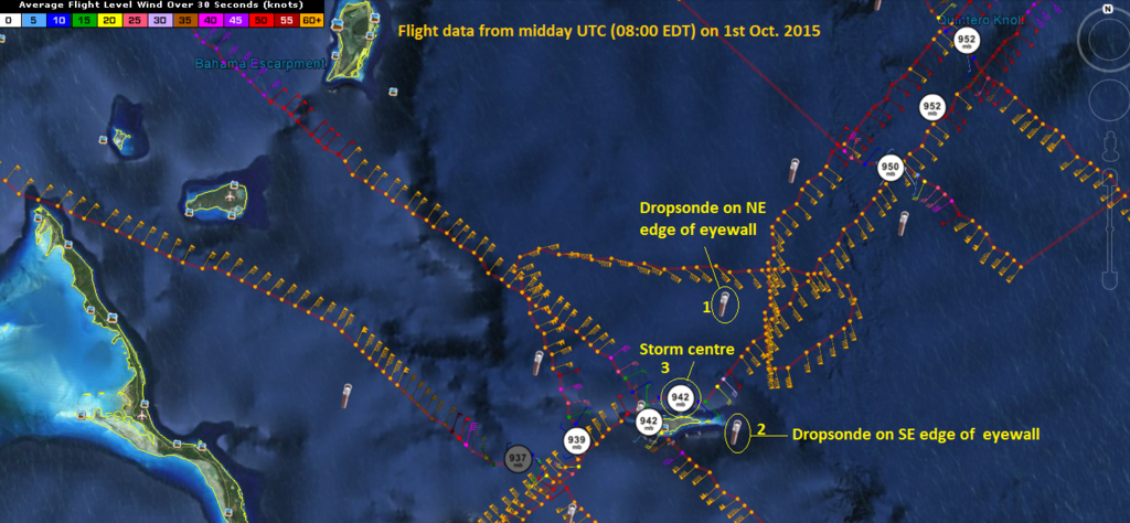

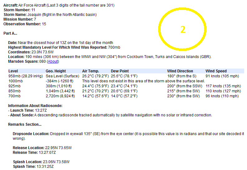

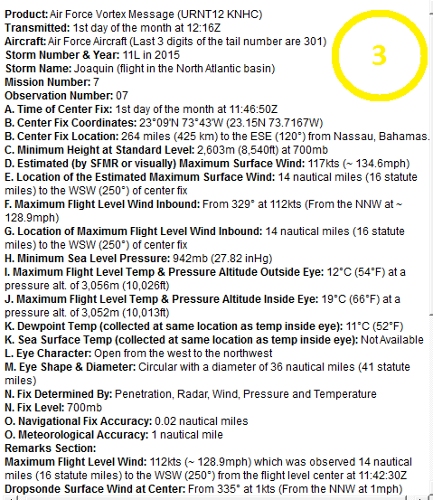

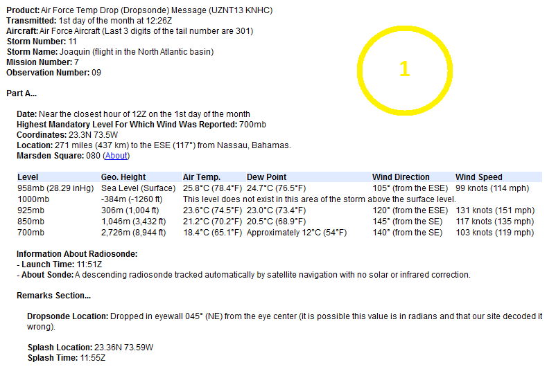

Here is some weather data from the hurricane hunter flight that made a pass through the storm and dropped dropsondes at midday UTC (8am EDT) on the 1st Oct. The positions of their records mean that El Faro must have been right on the western edge of the eyewall at the time communications were lost. The eyewall was 36nm across. It is possible that they got to within 20 nm of the centre of Joaquin.
Max surface winds were at 117 kts at 08:00 EDT.
http://aircraft.myfoxhurricane.com/recon/archive/storm.cgi?year=2015&storm=Joaquin&product=URNT12
[QUOTE=Mat;179770]Local time - which would have been EDT I think.[/QUOTE]
Bahamas time is UTC - 5: http://www.timetemperature.com/caribbean/bahamas_time_zone.shtml
