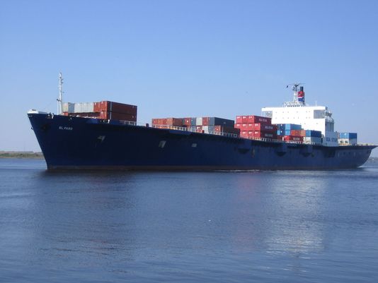

USCG now going on assumption that EL FARO foundered
[B]Ship that went missing during Hurricane Joaquin likely sank, Coast Guard says[/B]
By Abby Phillip and Michael E. Miller October 5 at 10:08 AM
El Faro, the cargo ship that went missing at sea in the path of Hurricane Joaquin, has likely sunk, the Coast Guard said at a news conference Monday.
“We are assuming that the vessel has sunk,” said U.S. Coast Guard Captain Mark Fedor.
The 790-foot American container ship and the 33 people on board have been missing for four days, and the Coast Guard has scoured more than 70,000 square nautical miles for the vessel.
Search crews spotted life rings, debris and an oil slick near El Faro’s last known location — but for days, there were no signs of the ship or survivors.
But the Coast Guard official said Monday that human remains were recovered in at least one survival suit.
Chief Petty Officer Jon-Paul Rios told the AP that the Coast Guard and El Faro’s owner have concluded that the ship was lost.
“We’ve been going with no sleep for four days,” Laurie Bobillot, whose daughter Danielle Randolph was aboard the ship, told The Washington Post on Sunday night from Jacksonville, Fla., where she and other family members of the crew have gathered.
The search continues for the missing crew on board, according to Rios.
“Not sure if you’ve been following the weather at all,” Randolph wrote in an email Bobillot on Thursday, “but there is a hurricane out here and we are heading straight into it.”
Just hours after Randolph sent her e-mail, El Faro began to take on water and tilt to one side, according to the ship’s owner, TOTE Maritime. Then the ship’s communications suddenly went quiet.
It hasn’t been heard from since.
