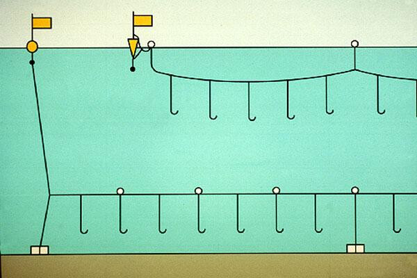

Long lines are passive fishing gear. I.e. long lines with baited hook set to passively wait for fish to bite. Can be set near bottom, or near surface depending on species of fish targeted:
Copyright FAO.
Trolling is an active fishing method as shown by Capt_Phoenix and explained by yacht_sailor above.
