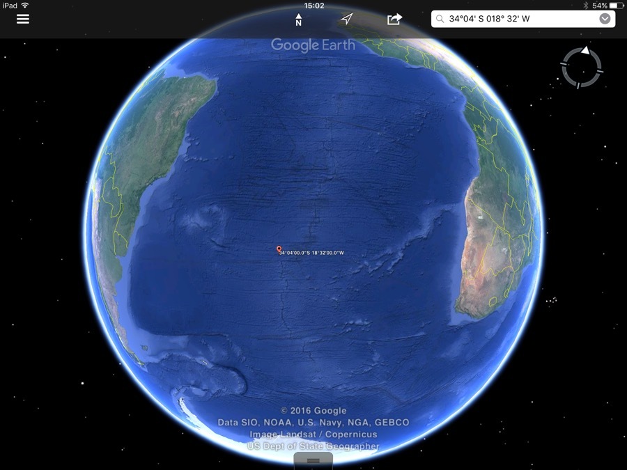

Does anyone know why the Uruguay authoritites are involved as it’s not their side of the pond?
Yah - and if there were any loading operation mistakes/calculations that would accelerate a catastrophic failure.
Uruguay has slice of SAR responsibility in the S. Atlantic between Brazil and and Argentina.
Thanks for the SAR map it explains a lot.
