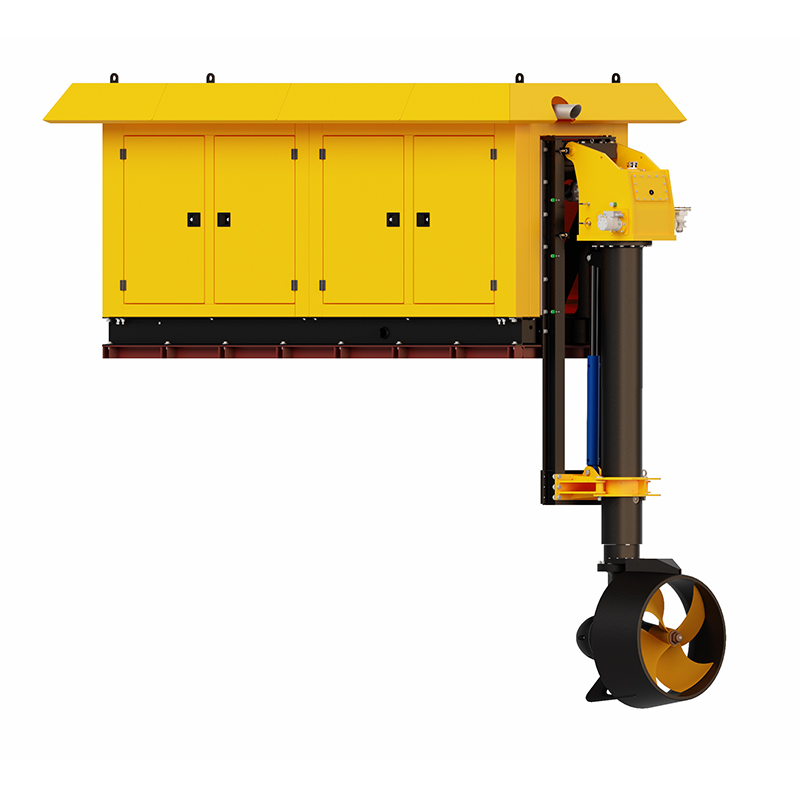

Am operation hydro master engine hp/rpm 150/2100, engine number U966900Y PROPELLER DIA 1016

I don’t know if I’m looking at the correct picture online but that looks like an interesting piece of equipment. Disclaimer: I’ve never worked with a Hydromaster unit. Is the diesel engine connected to it a Perkins which I found was common online? As @yacht_sailor said, you will need to verify what oil pressure you are actually getting & if it is low or not. Hopefully your engine has a lube oil pressure gauge to monitor, to see if the alarm is sounding at the correct pressure or not. If your mechanically inclined & have a parts store nearby this is easy to test if you don’t have a gauge.
