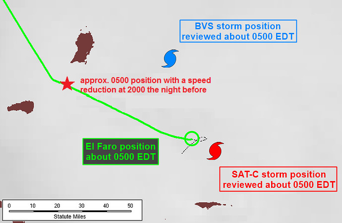

I still say no other route need have been taken…all that was needed to remain safe was to order a reduction of speed down to say 12kts at 2000 until the time the captain returned to the bridge in the morning to assess the best course to take. I believe they were making turns for 18kts? From 2000 to 0400 the reduction in speed would have placed the ship 48miles further away from the center of circulation and with the 0500 position of the storm as shown well away from the worst winds and seas.
Somehow Davidson was utterly convinced that Jaochim was going to turn north during the time he slept so that when he awoke, the ship would be riding the wind south of the storm’s center…HOW UTTERLY WRONG HE WAS AND THE MATE’S COULD SEE THAT WHILE HE SNOOZED COZY IN HIS BUNK!
once again it is seen that a simple reduction in speed of advance by a nominal amount can pay dividends many times their small initial cost.
