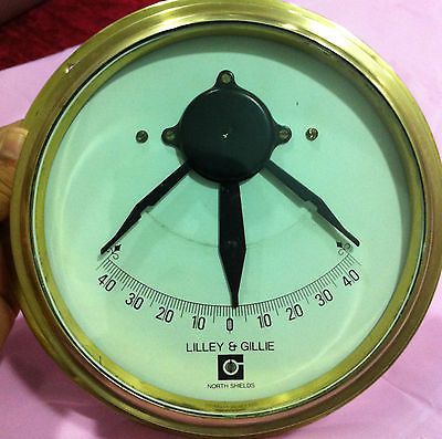

Kinda fuzzy, but that looks to me like an inclinometer with the drag pointer at about 45 degrees on the Stb side, a little less on the port. (MSC Zoe)
It is an inclinometer alright. I don’t know what your source was. So far I have not seen any pictures of bridge equipment which were taken post accident. It is unlikely that a roll of about 40° or more could be caused by 5 - 7 meter waves. It could happen with parametric rolls but the circumstances were not right for that, I think.
IMG_4280
Similar inclinometer.
The inclinometer in the picture looks a bit old school, I would expect an electronic device on a modern ship. On rolling vessels the usual bubble or pendulum inclinometers indicate values which are too high. This margin error can be up to 30% of the measured value. Electronic inclinometers will not be affected by accelerations but will indicate the true inclination and roll period.
An electronic Inclinometer as this one is an advanced heel and pitch measuring device which is not sensitive to horizontal and vertical accelerations.

You posted it.
Oops, didnot recognize it, my mistake. Old school inclinometer after all.
