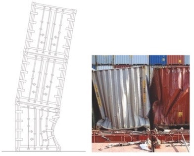

IMG_3985
Excessive compression force on container corner post, leading to failure of post.
From the pictures of the MSC Zoe I could not find signs of failed container posts. It is indeed doubtful if the crew size is sufficient to check the lashings of that huge number of containers and correct it.

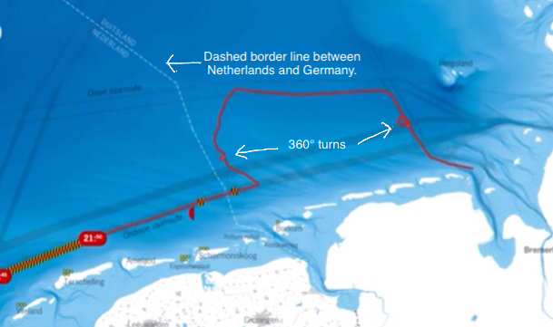

The ship turned round twice. Was the second turn made at the pilot station? It is not clear what the reason was to make the first turn at 04.30 am in this kind of weather. It was suggested that this was done to inspect the bays with lost containers but I doubt that. It is better and safer to stay clear of containers which are on the move.

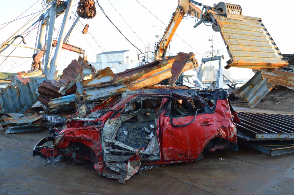

So far only 18 intact containers have been salvaged as well as 110 broken containers and in total 1.1 million kilograms of debris has been cleared from the sea bottom. The two containers with dangerous substances have not yet been found.
A sheer endless stream of waste from the broken containers is brought ashore and sorted: plastics, fridges, freezers, washing machines, car parts, compressors, lots of tools, hundreds of car tires, pots and pans, lawn mowers to name a few. About 20.000 dead common murres have been found in the area. It is unclear whether this was caused by the accident with the containers and is now under investigation.

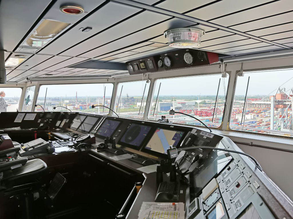

The picture shows the MSC Zoe’s wheelhouse.
I’ve got a theory that when the tug boat guys lay their binoculars down they lay them down flat, so as not to fall over in a sea. Looks like no tugboat men on that bridge.
