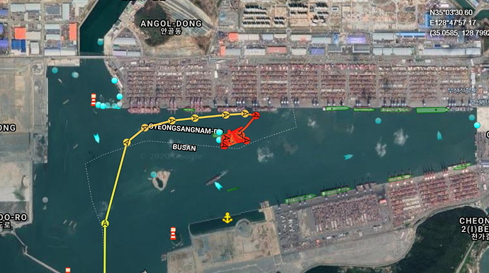

I do suspect a mechanical problem. Speed just doesn’t look right.
The problem I see with the mechanical problem story is the track. If they couldn’t control the speed why didn’t they take a different track? Why didn’t they say further off the pier? They had all kinds of room to stop a little further out.
Not disagreeing on that point, appears they had slowed down somewhat after turning towards the dock. But for whatever reason , that next to last leg shows a definite speed increase. Jury out on what that reason was. Either way, bad day for all.
