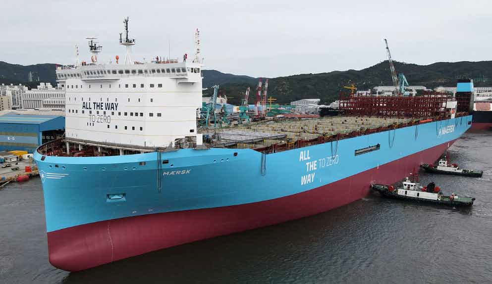

The first in a new series of 12 methanol enabled container ships, made her launching and undocking milestone last weekend. Unveiling the first of our large ocean-going vessel class with dual-fuel engine able to operate on green methanol.
Big and Beautiful. Measuring at 350m in length and 53.5m beam width, with capacity to carry 16200 TEU for our customers.We are partnering with industry leaders Hyundai Heavy Industries and MAN Energy Solutions for delivery of the first large container ship in early 2024.
