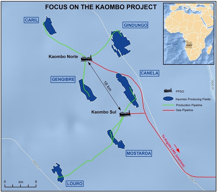

Total has started production from two FPSOs offshore Angola:
Seen here in operation:
