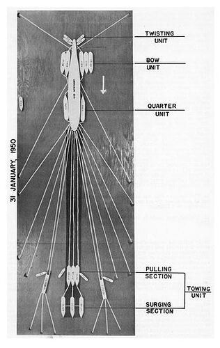

It beats me why there is no transparency about her final drafts after grounding and why they used such a laughable number of tugs in their first and second attempt.
Yours and other viewers calculations ( with 11 mtrs) clearly demonstrated , the forces involved to overcome are TREMENDOUS and epic salvage of USS Missouri in 1950 required not few tugs but an ARMADA OF TUGS .
Cheers.
Spowiednick.
I am happy to accept your 12.4m although note that your 15m baseline is not parallel with the boottopping line. It is a moot point.
The “Missouri” grounding makes for interesting reading and basically was a one man accident. Captain Brown was court marshalled and pleaded guilty. The vessel drove up on the sand/mud at 15 knots and every bit of excess weight including fuel, provisions, munitions, anchors and chains were removed to facilitate refloating. The grounding track for her was dredged prior to being towed clear stern first by a number of tugs.
You can draw parallels with the EF. The recents efforts to free EF have been tokenistic……nothing more, nothing less. There is a lack of appropriate infrastructure to facilitate a resolution.
They either need to get the right machinery in to fully dredge behind, at the sides and beneath the vessel or lighten the vessel to regain buoyancy or……a combination of both.
Attempting to skull drag 150,000ts through mud is a complete nonsense and they have failed twice.
This is what the Kiwi’s used to lighten the “Rena” when she drove up on a reef off Tauranga New Zealand. This was in an open sea, dynamic environment.
