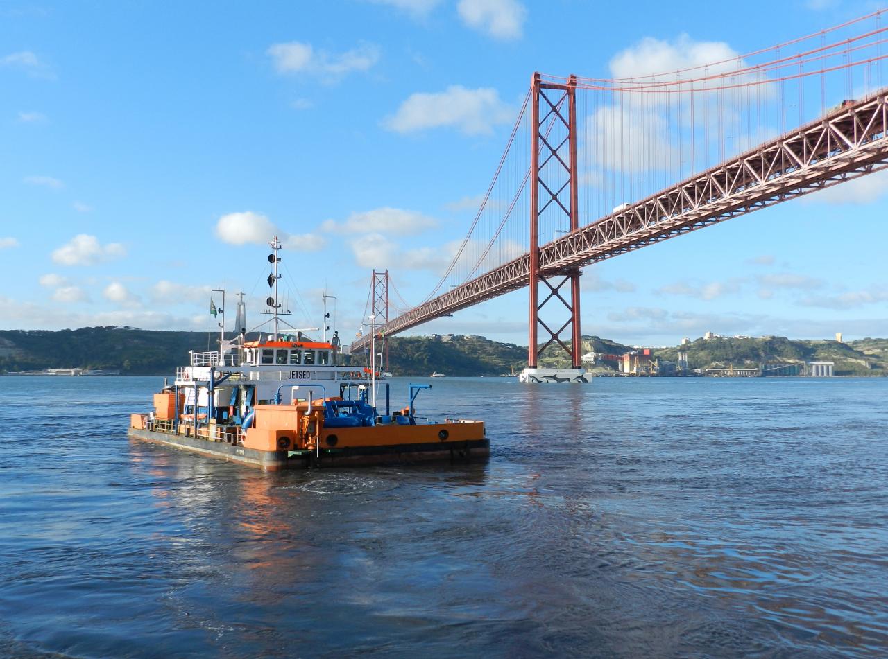

Are there any jet/water injection dredgers available in the area?:

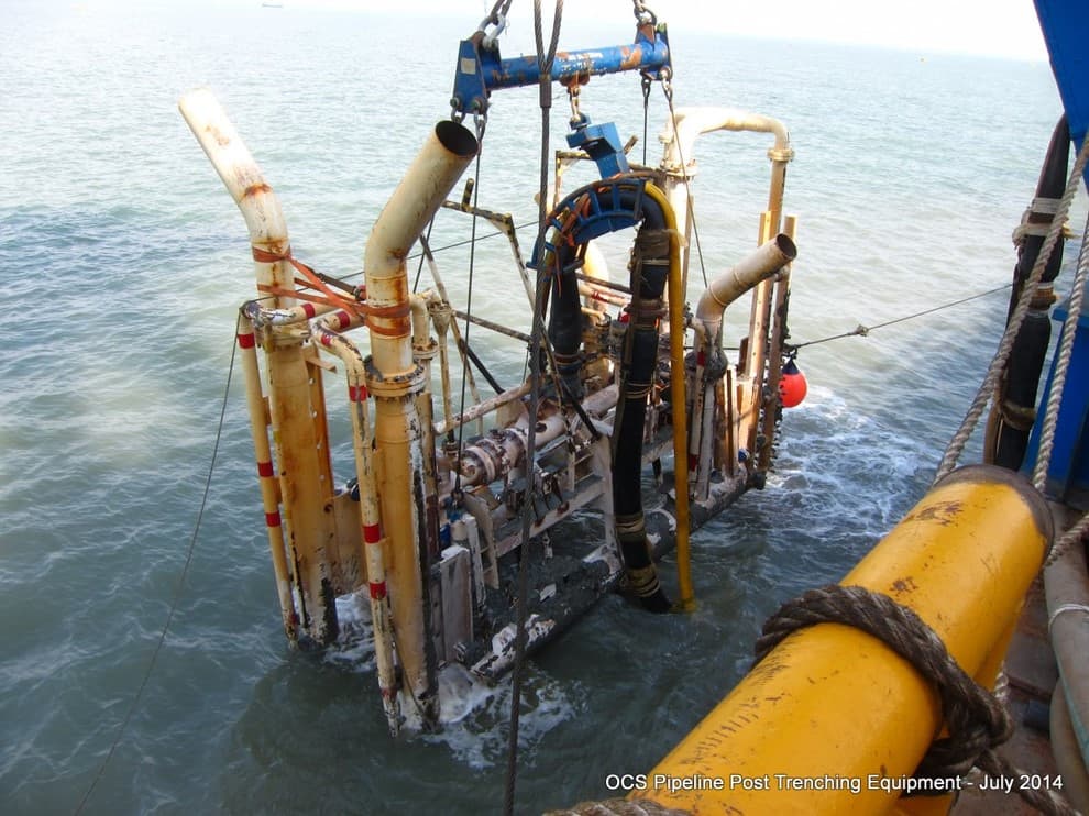

Reminds me of the burial sled that was used in the North Sea on the Forties Field pipeline.
I have photos of the thing someplace and will post them if I can find them. It looks something like the photo below. it was powered by 4 gas turbines, 2 for air compressor drive and 2 for water pumps and could dig a hole big enough to bury the entire ship in a day or two.
