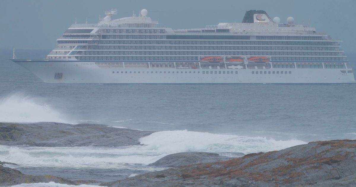

I think he needs to lay out his proposed mechanism of failure in more detail before it can be understood.
The way I read it: Since the motors are situated in the fore and aft direction, with the luboil tanks long, narrow and less than full, the liquide will splash towards the bow end when the ship is setting hard in head seas.
It is a well know principle, which is used in ant-roll tanks and is a consideration for bulkhead strength in large tankers etc.
In this case; If only one suction and that is situated in the middle, or in the after part of the tank, the luboil pump can lose suction, resulting in loss of oil pressure to the engine(s). If the tanks were full there are no problem with this, but it is know that all the luboil tanks were at low level, although within the required minimum level.
That makes it a simple problem to avoid, and instructions to keep the luboil tanks on other engines of this type at a near full level has been issued by NMA, MAN, LRS and DNV.

“Pitching” is the vertical motion caused by seas from ahead
“Setting” is caused by running hard into oncoming seas, causing a momentary slowing of speed. It also cause “slamming” on a ship with a bow configuration like the Viking Sky.
These two reaction cause liquids in tanks to move far beyond that from the inclination of the vessel. It also cause acceleration, which make liquids in less than full tanks to pile up against a bulkhead with force. This is also something being considered for lashing calculations.
On HLV it is frequently necessary to leave some ballast tanks slack to avoid too fast motion, causing excessive strain on lashings and to much cribbing pressure due to acceleration. Bulkhead strength is also considered in the planning.
