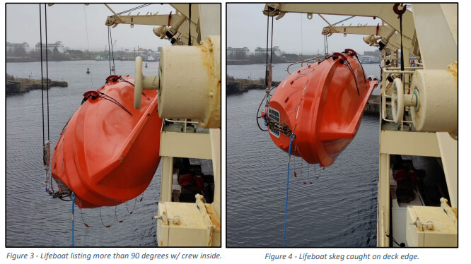

There have been problems with this arrangement. A lifeboat was lost from container ship during a drill at full sea speed a few years ago because of a problem with the remote control wire, nobody aboard.
The issue is when the wire spools onto the drum improperly. There is an article here:
USCG: Unexpected Dangers: Lifeboat Remote Control Wires
USCG safety alert here: UNEXPECTED DANGERS: LIFEBOAT REMOTE CONTROL WIRES

On an enclosed lifeboat the remote control wire will foul on itself on the drum if it did not spool on properly. Is there something different about the arrangement with a rescue boat that prevents this from happening?

Not a enclosed lifeboat designated as a rescue boat. In that case the remote control wire is on the davit and is designed to, but sometimes doesn’t, pay out at the same rate as the falls.
