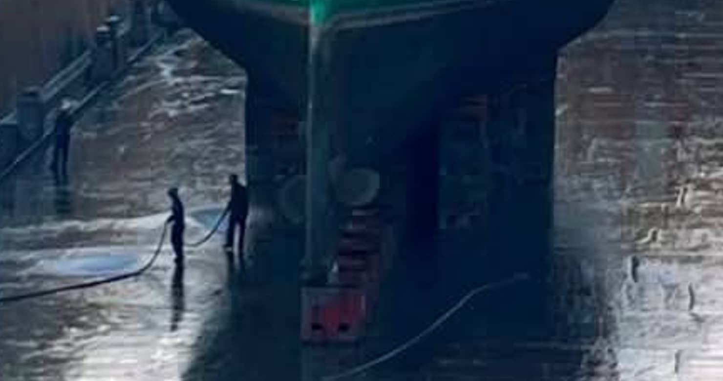

This was posted on FB on Jan 20 of Cuauhtemoc in drydock and it looks like a fixed prop. Marine Traffic has her in Mexican Navy shipyard in Salina Cruz and shows her in a drydock, so I think this is a current photo.
I can’t tell from those - don’t know
It is hard to tell.
