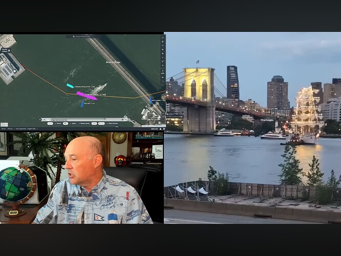

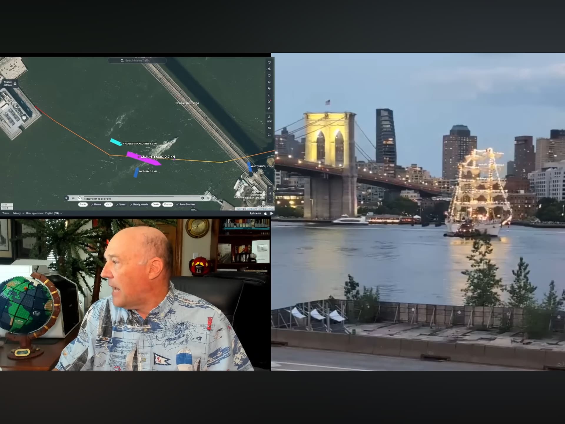

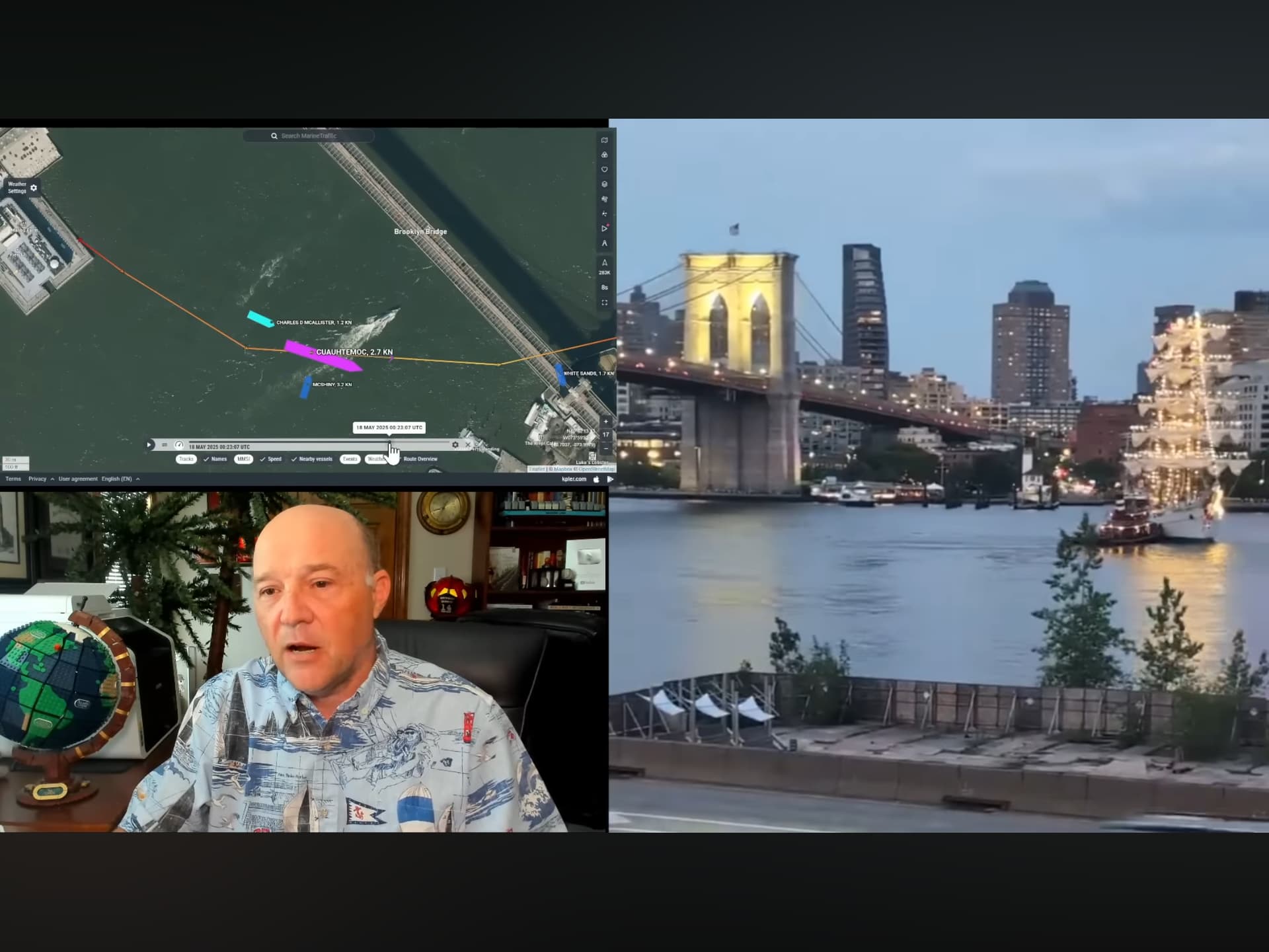

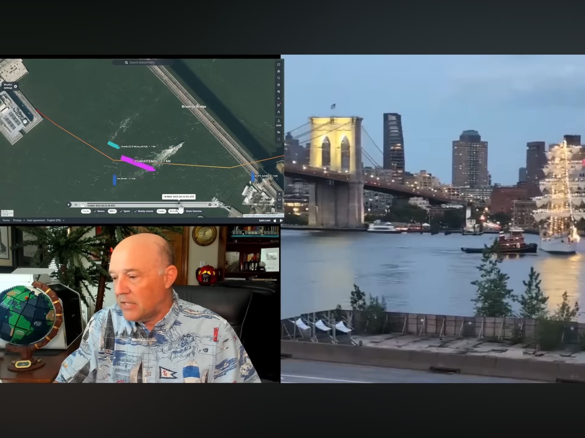

The Marine Traffic and attached video were not correctly synchronised.
