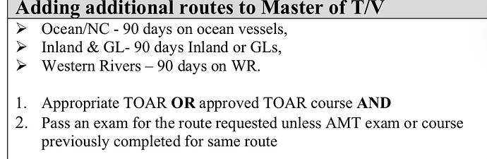

Adding NC Route to MMC Question
^ snipped from the MOTV checklist
I’m doing research on adding the NC towing route to my MMC, according to the checklist for adding a route, it appears I only need the TOAR and an exam or course for the route as well as 90 days on “ocean” vessels.
Since I already have a tonnage NC route that is not for towing, would that apply to meet the course/exam requirements to add the towing NC route or is the checklist course/exam towing specific ?
You need the sea service in addition to the TOAR and exam. The service has to be on towing vessels.
If you have Master Towing Inland you can get MATE towing inland with just an exam. See footnote 1 to 46 CFR 11.464(a) Table 1.
Thanks for the reply. I didn’t mention it above but I already have Master of Towing Inland / WR.
I also have national 200GRT NC which is the focus of my question. Since I’ve already tested for the national 200GRT NC, would that satisfy the exam/ course for adding a NC towing route to my MMC ?
