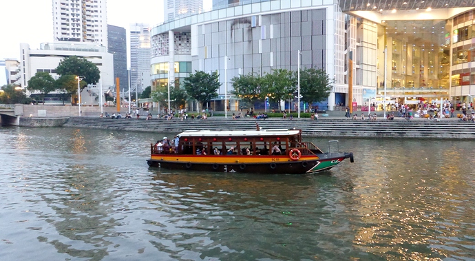

The new River Cruise boats that operate in Marina Bay and Singapore River only also have Singapore Government (SG) loadline:
PS> These are electric powered since they operate on a reservoir. (Why are the Ducks allowed??)

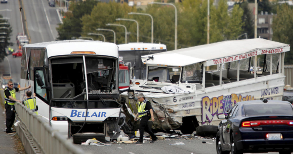

Apart from the unsafety on the water It remains to be seen whether it is safe to drive around on land in modern traffic with a dinosaur hybrid Duck with limited driver’s field of vision. The NTSB issued a Safety Alert in November 2016 after a couple of serious road accidents that occurred with Ducks.

Keep in mind this accident happened in Seattle. The DUKWs in Branson may have different features.
