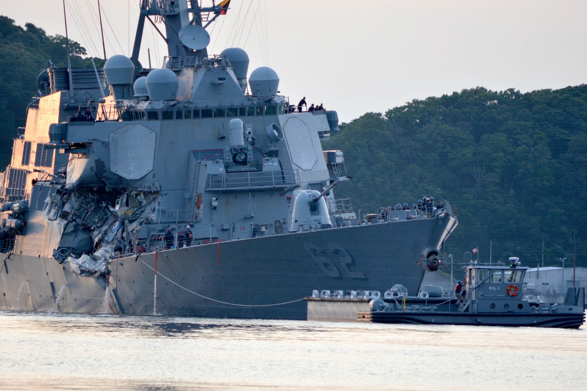

Why won't the Navy release the USS FITZGERALD's track?

I don’t see any security problem with releasing the track of the Fitz immediately before and after the accident. It’s not like it’s a state secret she was in the vicinity. What would be the harm?

I’m sure the navy will release the track, but all I good time when their internal investigations are concluded.

I’m going to be the devils advocate here too and suggest that perhaps the bridge crew on the Crystal thought it was a false echo on radar since there was no AIS signal, and thus ECDIS didn’t flag it either (if their ECDIS was setup properly with the radar inputs). It’s no stretch to say that all too many mariners these days get tunnel vision with the bridge electronics and fail to look out the windows all too often. Now, on the other hand, if the Fitz was running dark (heard many quotes of exercises being conducted, so maybe?), then the Crystal had a radar blip, and a big black hole where a ship’s running lights should be, so it’s again back to the Fitz to be the give way vessel (granted, by COLREGS it was from the beginning but it would put a whole lot more of the responsibility squarely on the OOW for the collision).
My $.02
What is the radar signature of the Fitz? With the radar evading structure she might have appeared on the Crystal’s radar as a small target like a fishing vessel without AIS. And if the Fitz was running dark, who knows what they were thinking in the Crystal’s wheelhouse.
