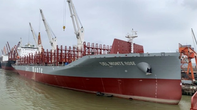

Even Del Monte is in on the act, with 6 new fuel efficient vessels for cooler container in the making;
The first ship, M/V Del Monte Gold, has already left the yard and presently passing through the Panama Canal:

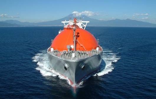

LNG is NOT the future marine fuel but a blind track according to the latest IMO study:
May meet the present requirement for SOX and NOX reduction, but not a carbon free solution.
all true and was never a secret but just seems more subterfuge from the shipping industry over a long period of time to do nothing and have excuses for why they have done very little?
I feel like with maritime there is a big push to conflate particulates and SOx/NOx with “pollution” in general. Any clean low-sulfur hydrocarbon is going to be an improvement in that regard, especially compared to pre-2020 HFO, but if GLOBAL climate change is the issue and not localized smog, you are talking CO2 and just can’t use a fossil fuel period. I see the most environmentalist people imaginable who still get this wrong and say “one ship pollutes more than 50 million cars” because they are talking about SOx only and don’t understand that ships are comparatively quite green due to the efficiency per ton-mile.
yes ton per mile they beat everything but if you live near a port your air quality is horrendous.
LPG would fix that but not the Co2 issue if that is the issue?
Yeah exactly. Best for the world out of any fossil option but sure not a good neighbor.

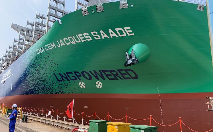

Is LNG a step towards shipping decarbonizing?:
https://www.hellenicshippingnews.com/lng-and-the-pathway-to-shipping-industry-decarbonisation/
A step maybe, but not the final solution IMNSHO
