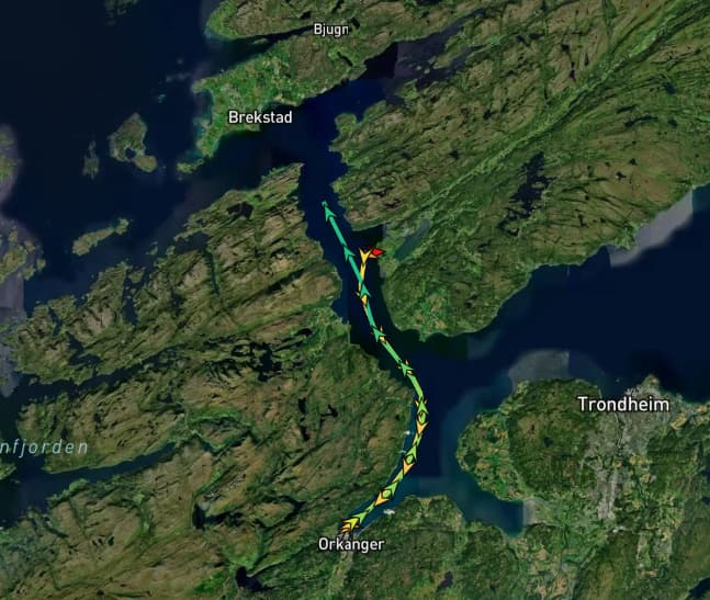

Nothing said about having a second person (lookout) on the bridge.
Probably because it was clear weather and bright daylight at the time of grounding.
The AB on lookout earlier had gone off watch at 04:20 hrs. according to the 2nd Off, statement /logbook
PS>Sunrise at Lat. 63 N 22,05, 2025: 03:56 hrs. CET
Source: Sunrise and Sunset Times for Any Location | CalculatorSoup

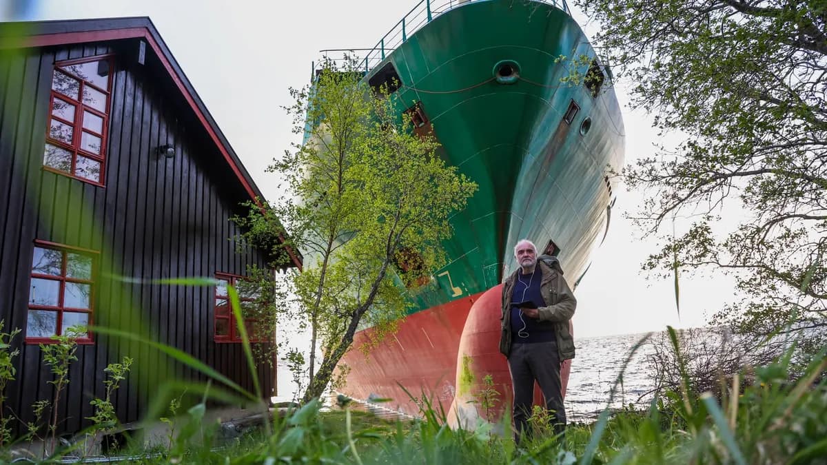

A house nearby is at risk because the grounding triggered the quick clay to collapse.
Quick clay can be a big problem in Scandinavian.
Scary that the ground can liquify so quickly under certain circumstances.

A picture from a more “dramatic” angle:
Photo: Jan Langhaug / NTB
The captain of the container ship denies criminal responsibility after the grounding at Byneset
Source: https://www.smp.no/nyheter/i/Rz7aa5/adresseavisen-kapteinen-paa-ncl-salten-siktet-etter-grunnstoetingen-paa-byneset
PS> The picture shows how close the ship was from hitting solid rock, not a sloping gravel beach.
