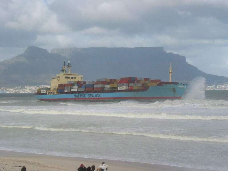

I vaguely remember hearing or reading about the grounding of the Sealand Express, but had to google it to refresh my memory. Classical case of ignoring reality until too late.
Nice picture of the Sealand Express on the beach:
