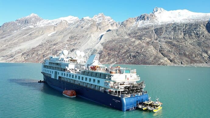

As can be seen the Ocean Explorer grounded quite far from shore:
Probably on such a “threshold mound”, which could have been reshaped by silting and drifting icebergs many times since last detailed bathymetric survey was carried out (if ever).
The Aurora Explorer is designed, built and equipped according to Polar Code 6 and has operated in both Arctic and Antarctic waters since new.
(I don’t know whether that include a forward looking soner, or not)
Unless proven otherwise, I would assume that the Master and Navigators on the Aurora Explorer were qualified for their position and experienced in operating in arctic waters.
Can we just say; “Shit happen when you sail in waters like the fjords in NE Greenland”.

That article says the ship ran around on the moraine of the glacier. Also mentions “prodeltas”.
On one TV news report one passenger said that the trawler that assisted was used to place an anchor which was used as to kedge off.
A “classic navigation error” on a ship with “the latest cutting-edge technology, sustainability and navigation capabilities”.
Edit: According to that article a similar incident occurred in 2014 to Ponant’s Soleal which grounded in a Siberian fjord. In that case the incident report recommended the company provide additional training to the crew.
“Alluvial fan” is a terrestrial feature, so not the correct term. A similar feature that occurs when sediment loads flow into standing water is called a “fan delta”. The leading edge of that fan delta is called a “prodelta” which is mentioned in the linked article in the precious post.

It is of course possible, but it is also possible that the Master and Navigators had years of experience in polar navigation and had read the Greenland Pilot.
After all this was a ship built for such voyages and operated by Aurora, a company experienced with such expeditions.
I don’t understand why you insist on assuming that this was some kind of “fly by night” operation, with unqualified crews and operators??
