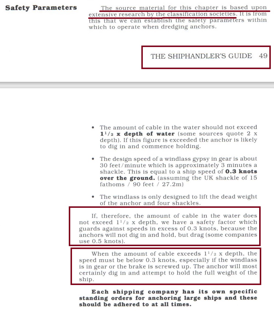

Absolutely perfect comment especialy about the use of anchors in this particular case . Letting them go ( few shackles) was pointles and luckily for the bridge team the anchors did not catch , otherwise both chains would be gone with such energy and mommentum. You made my day today. THX
You have to try everything in Emergency , anchors in particular , points for insurance Company and standard procedure as well. The only thing to decide to drop or not , are the submarine cables ( power or internet EX: Singapore) , might be more expensive than the outcome .
Once again a good point understood by 5th/6th graders.
As You wisely observed staying on anchor is not the same as dropping it while underway . In some ports we let go anchor under way but under strict conditions of paying out no more then 1.5 x depth of water and it was on shallow waters to stabilize the bow when going stern in , when tug was not available or bow thruster conked out . Coasters of abt 5000 dwt.
And You are absolutely right . In the first case we are dealing with static situation, when all the forces acting on the chain equalise and are acting in oposite directions like in “action versus reaction” example.
In the second example we are dealing with dinamic situation and it is a diferrent ballgame. Some of the gents here may be, should consult as a minimum Halliday and Resnick’s Principles of Physics instead of exploring in depth their egos. It is never too late to learn sth.
I’ m open mind , don’t worry , I know I’m learning every day , thing is , I have procedures to follow as well , at the end , the only question will be : Why ? And most of the procedures are done and updated after incidents like this. I will still drop anchor in case of Emrgncy , is just me .

You are correct that letting out 5-6 shackles of anchor will not work. The trick with using the anchors to stop the ship with headway is not to let out more than one or two shots of chain. You want the anchor to drag, but not to catch. If it catches it will break the chain or pull it all out. At one or two shots there will still be considerable slowing effect, but the flukes will not bite in. Yes, it will bounce along on the bottom, but it is still useful drag. You have to be careful to tell the mate on the bow to pay the anchor out with the winch (if there is time) or to let it fall and IMMEDIATELY put the brake on.

You have replied to my comment , where I have spoken to Alias Sirk . I have placed two additional comments including pdf page frm a trusted source - Nautical Institute of GB, that in plain language explains and confirms my position.
I did employ this technique on smaller ships what I have mentioned in my previous comment.
There are a number of publications from competent institutions confirming above and i have them and read them many times. I will provide link to one of the participants who mentioned, He is still in the learning process
