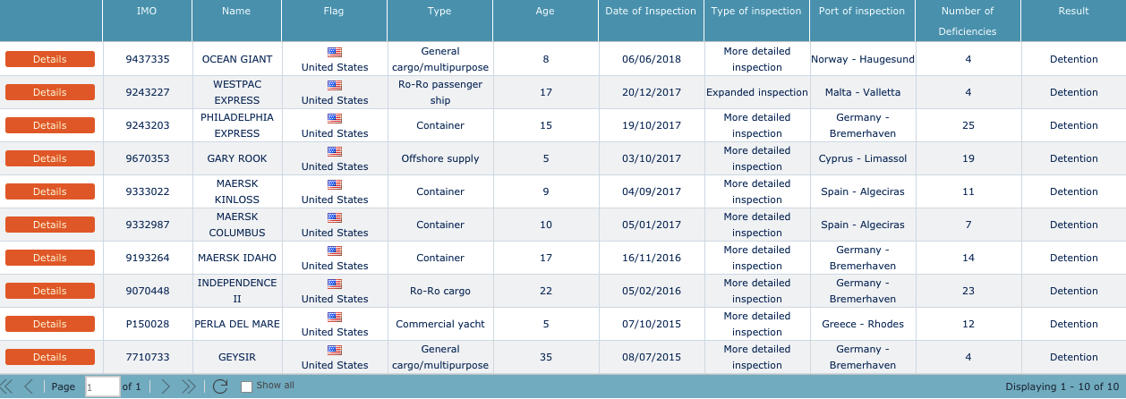

I have been searching in Norwegian records and media but cannot find anything about detention of a US-flag ship in Norwegian ports this year, or last.
Have you got any details, like ships name, port of detention, or if there where more defects than a radio cert over/near expiry date?
Paris%20MOU%20-%20US%20Detentions%202015-2018
Some of the detention lists are lengthy.
The Paris MOU has a pretty good search function - https://www.parismou.org/inspection-search/inspection-search
Thanks!!
OK reason for detention is given as the expired Safety Radio Cert. (Exp.04.06.2018)
There were also three other deficiencies noted, but not amounting to detention.
There is one exemption from the +/- 3mth. rule, which is if the vessel is embarking on a voyage that will cause the extension time to be exceeded.
In this case this MAY mean calling at a US port within that period?
(Or can the annual survey be carried out by authorized surveyors outside USA?)
